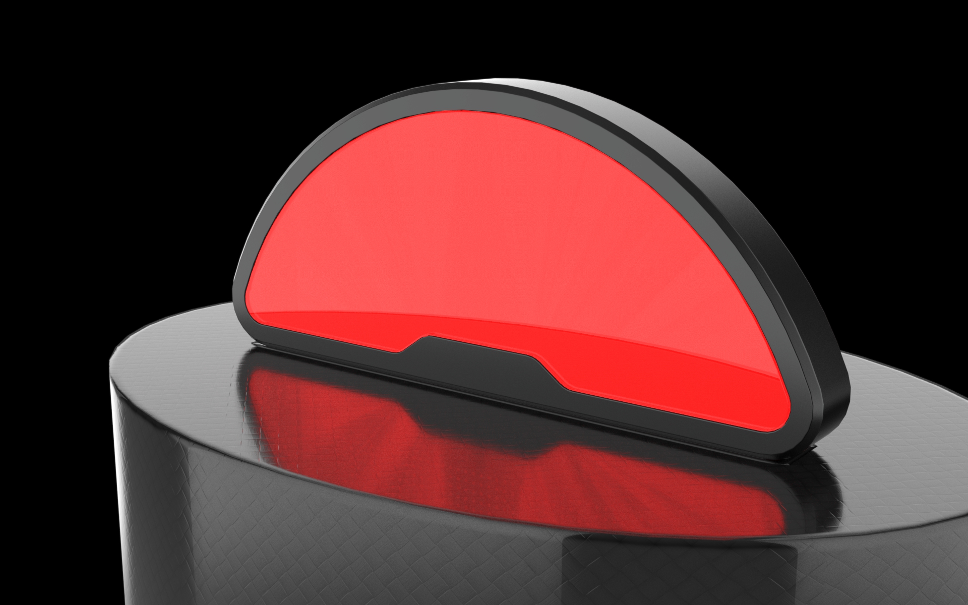

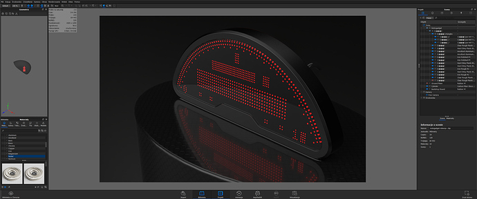

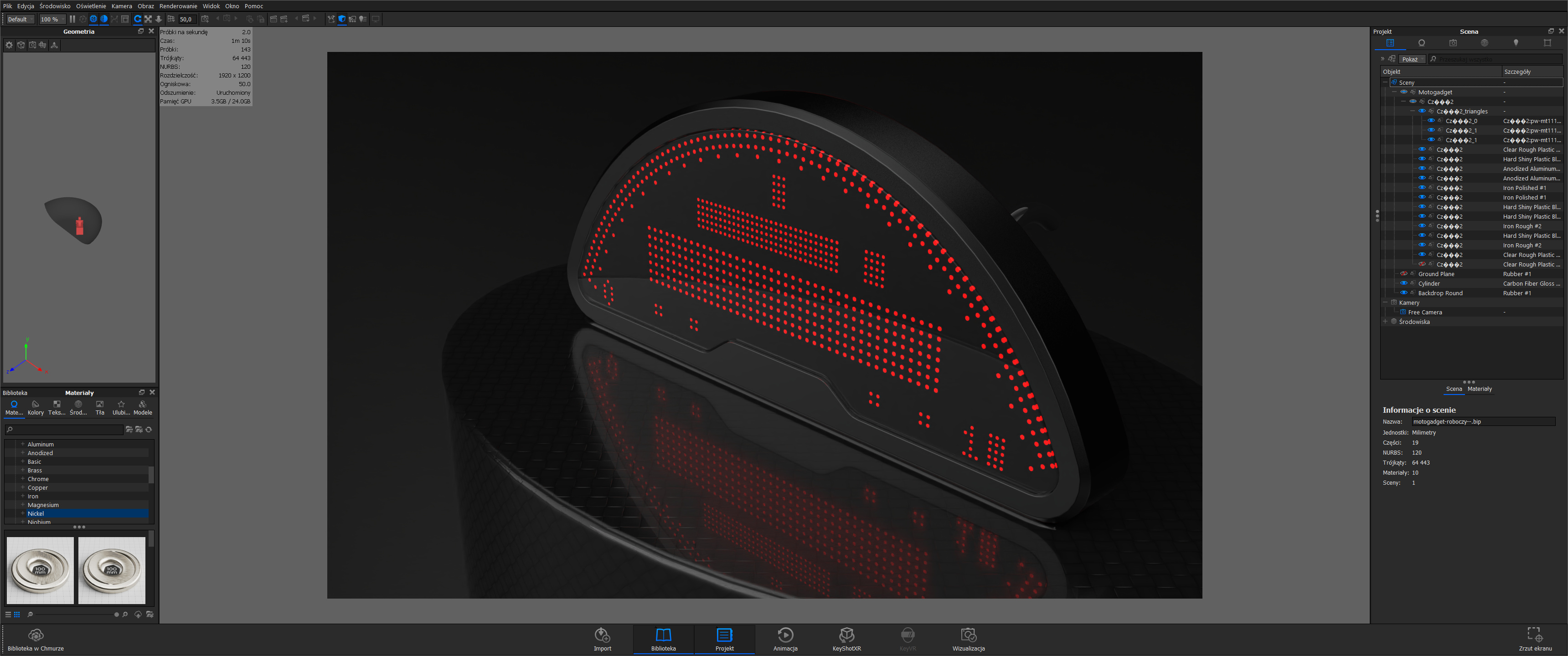

One of the image is CPU render (2 CPU workstation with xeons on board) and second is GPU (nVidia Quadro M6000 24GB)
This is GPU
This is CPU
I don’t know why is such difference between this shots
This is GPU
This is CPU

Hello, maybe if you can share this scene, so we can open it and see what’s going on. When you are in the GPU rendering mode, and you hide that glass, how it looks? Its just the glass which is not working right or its the material behind that glass not working? I believe the material behind that glass is not working in GPU mode. are these small dots emissive material?

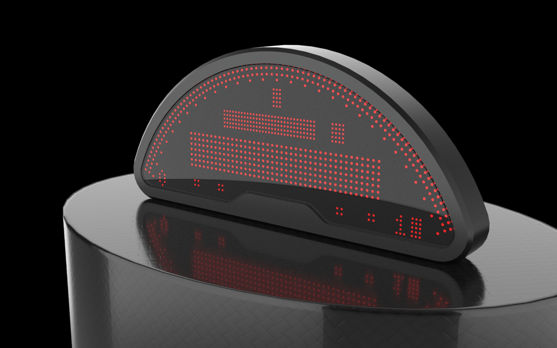

@TextureMan, yes, there is a glass panel and behind is emmisive material with gobo mask (illustrator file). Your suggestion are correct - i found an issue - double glass in one place, when i removed on “layer” on GPU now is everything ok

Sounds like the issue could be the number of ray bounces too. If you turn the glass back on (both layers) and increase ray bounces, I wonder if it will become transparent. Perhaps no matter how many ray bounces, the double glass will remain black. Glad you figured a solution!

i think that next render will be as shown on picture with details, maybe i will try some animation (but i think that my workstation is too old for this).
This last render looks really good. Nice job I really like the design of it. It would be nice to see even simple animation of this in the future
